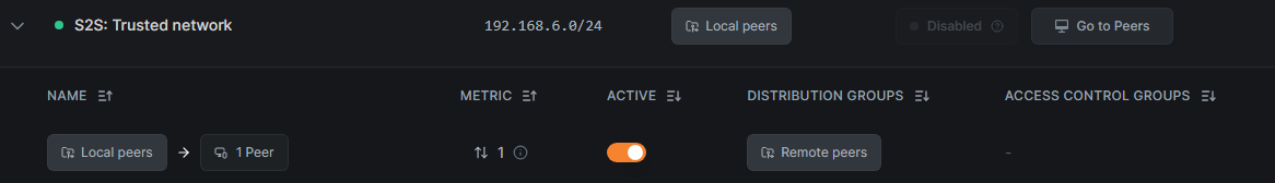

I have a network route in place for this with a Peer Group containing just the local peer, and a distribution group containing just the remote peer (although I intend to add others once it works).
