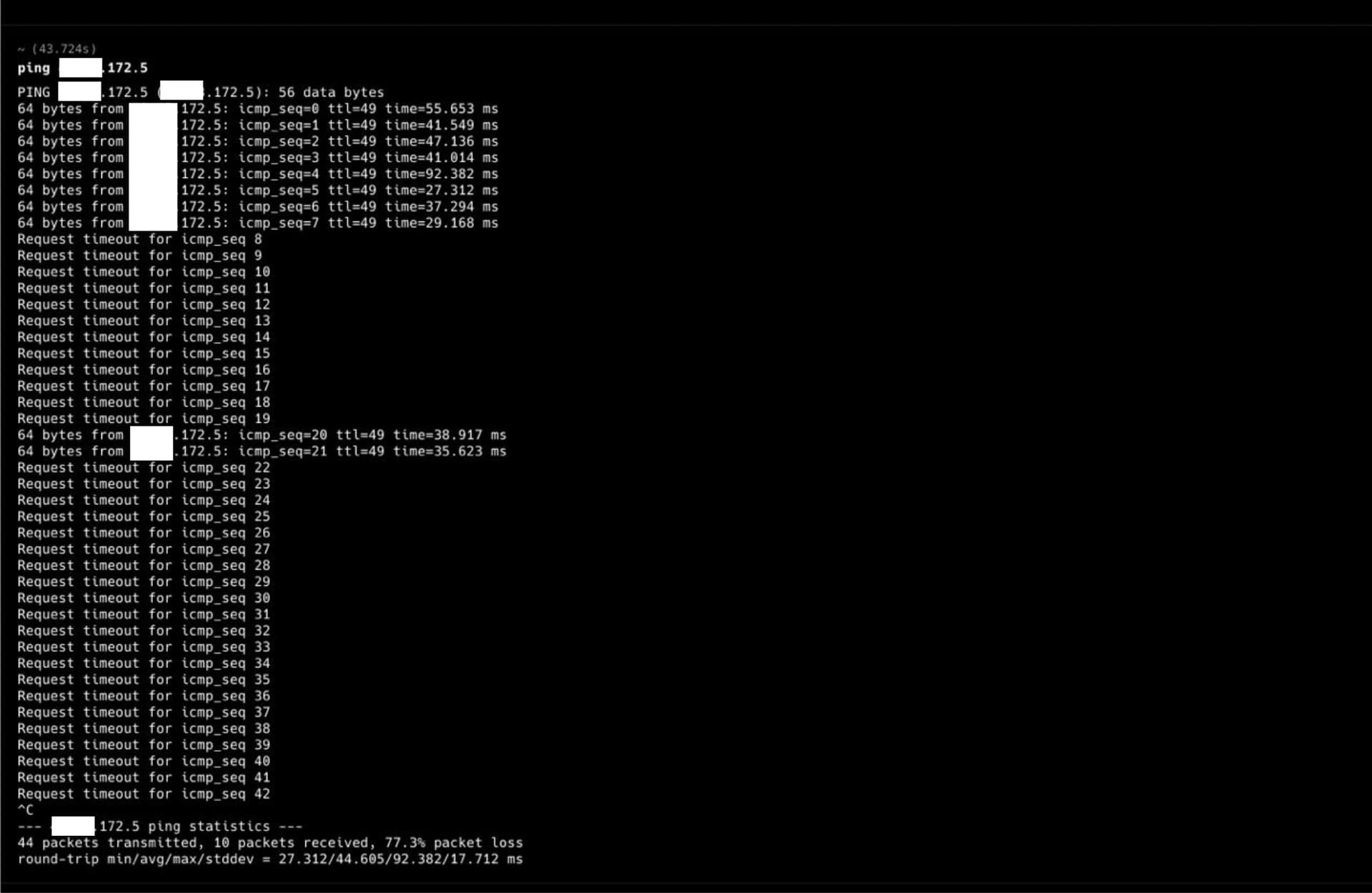

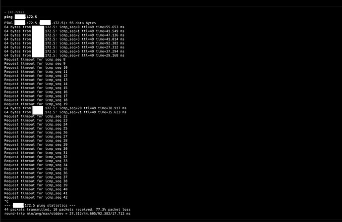

Random ping timeouts when agent is running on a VM with a public IP.
I’am pinging the VM via it’s public IP and it looks like my machine is sometimes trying to reach the VM over the public IP and sometimes over Netbird but I’am not sure. As soon as i stop the agent on the server, pings are normal.
Basically i just want to know: Is it bad to install a netbird agent on a VM with a public IP too?
My idea was to use the public IP for normal web traffic, and Netbird for exposing some internal management dashboards.
Can i somehow tell the agent to not publish the server’s public IP to the client so i can only use the IP assigend by Netbird?

  4. Try to ping the VM’s public IP
Pings to a public IP should always be routes to the public IP directly.

Public traffic shoudn’t be affected unless you assign the VM a route that makes it follow a different connection with like an exit node. Check your policies, or reset the configuration for that machine in the NB panel and see if that affects the ping in anyway.
