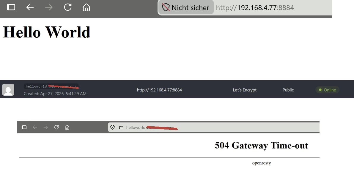

Is NPM capable as reverse proxy with source from other peers?
what does not work:
Cant reach services like nextcloud, nginx, adguard, .. with NPM (instead of internal reverse Proxy) on other subnets on peers.
what does work:
lokal subnets whos in the same physical network are reachable through NPM and all hostet services works (nextcloud, nginx, adguard, .. ).

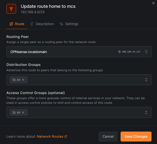

I need clean advice on how to expose services with npm where the source come from peers on other subnets
I need Netbird as replacement for my existing solution with site2site wireguard and zoraxy reverse proxy between “homelab proxmox” ←→ “Hetzner vps“
self-host NetBird’s control plane.
v0.69.0
wireguard on my “opnsense firewall vm” on my “proxmox host” (Port 51825)
site2site wiregaurd on “local proxmox vm” between Hetzner (51820 not exposed in local Firewall)
“Both shouldnt interference because i use this setup localy in my homenet for testing before i switch to hetzner”

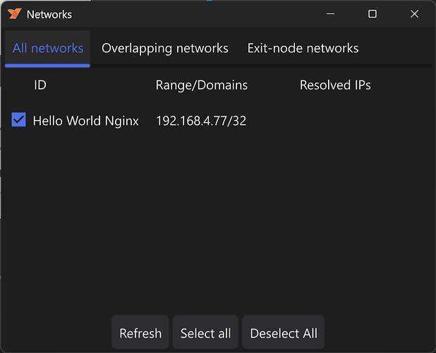

Networks: 0.0.0.0/0, 10.0.0.0/24
Peers count: 1/3 Connected
