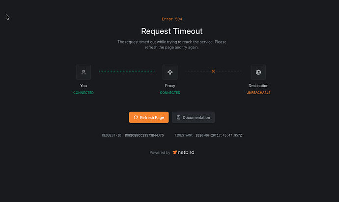

Netbird Reverse Proxy broken after Update to v0.73.1
I just updated my netbird server to v0.73.1. Immediatly the reverse proxy stopped working.
Im pretty sure I was on v0.72.4 right before.
To Reproduce
  1. Update Netbird to v0.73.1
  2. Try to access reverse proxied service
  3. See error
For it to show forward correctly to the service.
Self Hosted
v0.73.1
No
Debug output

Screenshots**
This happened right after updating. Going to a previous version didnt fix the issue however.

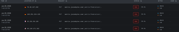

Hello, I am having the same problem, could you solve it?
I have the same problem, exept, that I installed Netbird new, does anybody have a solution?
Can confirm this issue after latest Netbird update 0.74.1.
I tried to update all the peers to latest version and figured out that some proxied services are unreachable, some are fine. This is really confusing.
