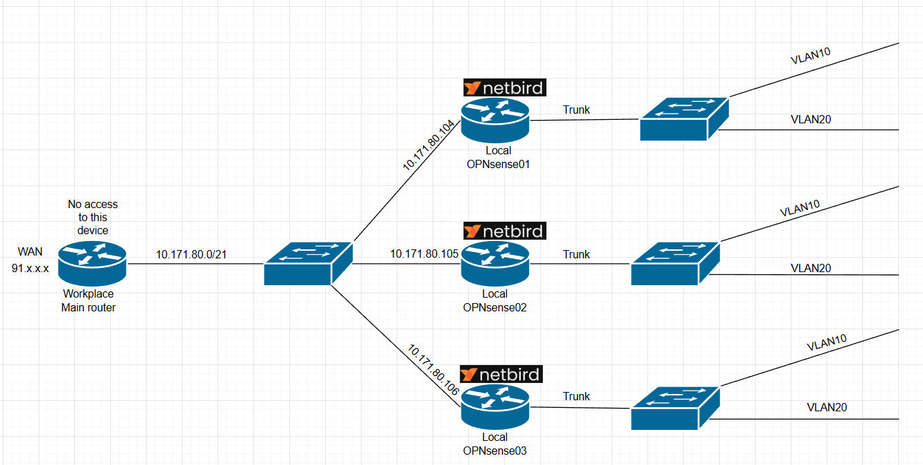

Want to implement netbird on several OPNsense routers.
How do I setup each OPNsense router so that I have access to vlan on each router (not at the same time) only want to have access to vlan on the specific router I connect to.

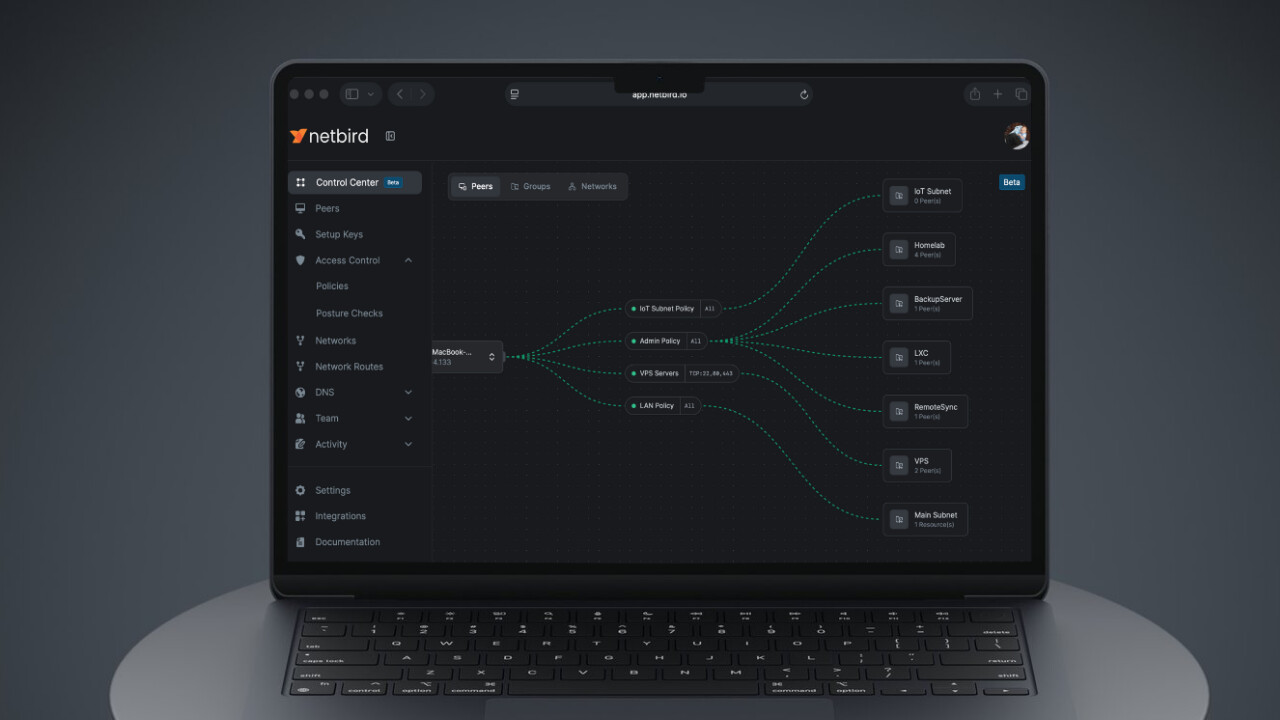

What I was thinking of was more in how to setup the webpage where some of the settings are done.
I think it is called the main central or something like that.

Do you mean the control central?
Yes
It is dificult to see what should be setup (what can be setup) on opnsense itself and in the common webcentral.
The control center is just an overview of what can connect to one another, not a full settings page to control everything (regardless of the name).
