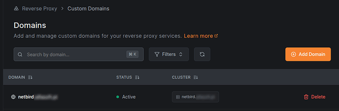

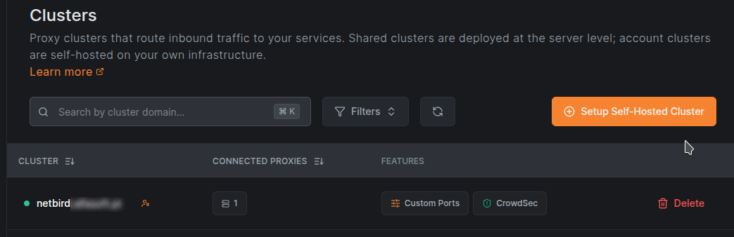

I already have the proxy cluster and custom domains configured:

I tested it and --with-custom-domain works correctly.
However, netbird expose <port> without specifying a domain still fails with:
no cluster domains available
So it looks like the CLI is unable to automatically select a cluster/default domain, even though the Dashboard can create reverse proxy services successfully using the same proxy cluster.
Is there currently a way to configure a default domain for netbird expose, or is this a bug?
