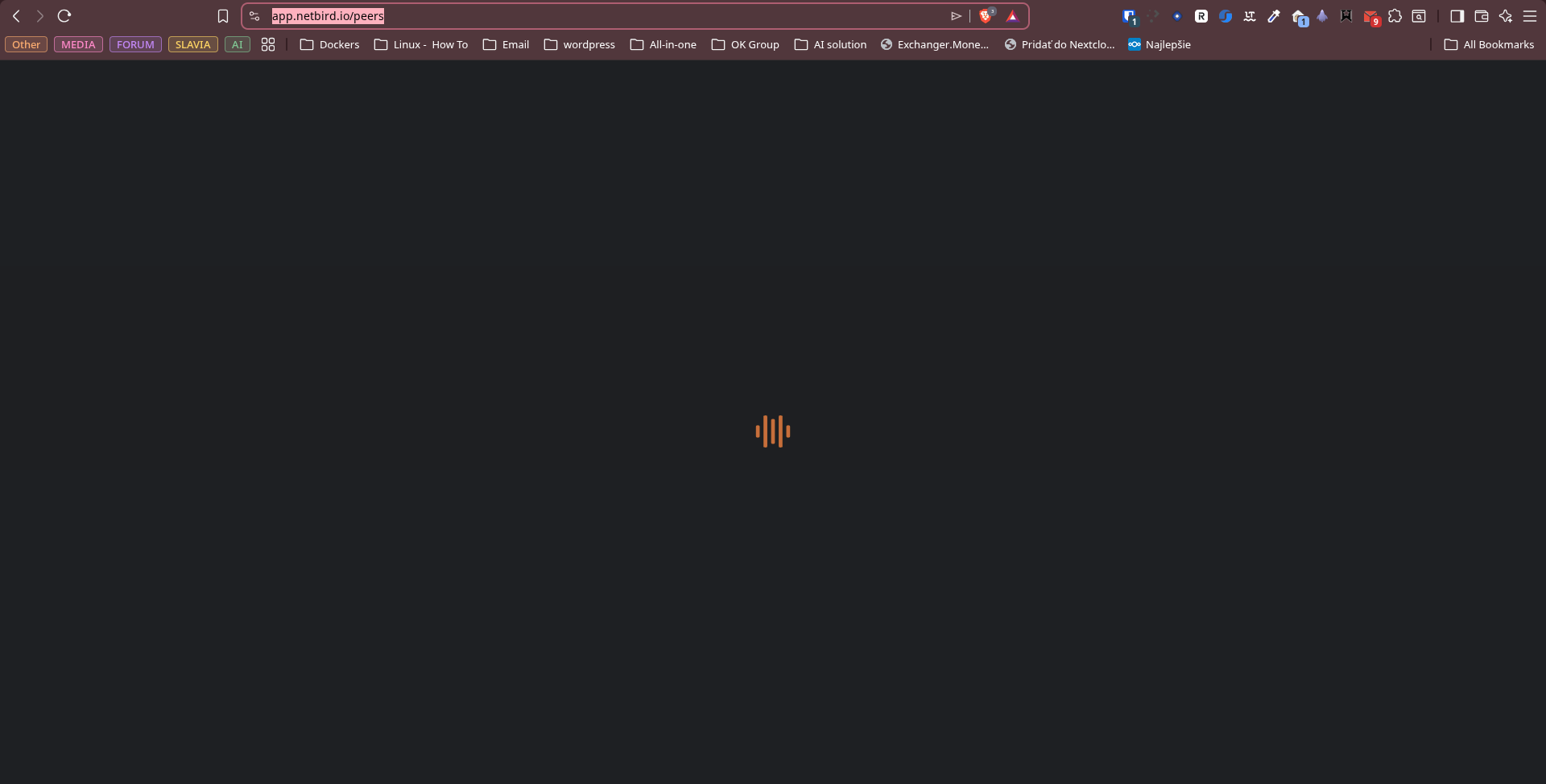

  • I also cannot properly load the Peers page in the dashboard at app.netbird.io/peers — it keeps loading indefinitely

At this point it does not look like a simple local Linux/systemd issue, because the same behavior happens across different browsers and different internet connections.
Question
Is there currently any issue on the NetBird cloud / dashboard / management side, or is there a known problem affecting account login, peer registration, or the peers page?
Exactly the same issues here. The page keeps loading.
Thought it was something in my infrastructure, but glad i’m not the only one.
Hopefully it will be fixed soon.
And I don’t see any groups at the moment and have the same login issues under windows
I see that Netbird Cloud service works again. Groups are available as well.
I have fixed my issue that was related evidently to not working Cloud portal service.
