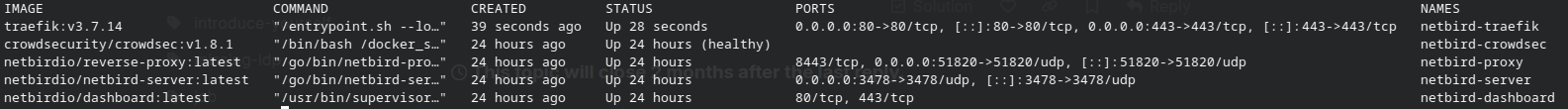

I tried to pass through port 3479 with UDP only to my Netbird peer using the reverse proxy feature. 3479 UDP to 3478 Nextcloud. This did not work up until now. Nextcloud tells me the connection to the TURN server is not successful. Port 3479 is accepted in my VPS’s firewall. Is it possible that I have to change a service’s setting? (E.g. Traefik only has port 80 and 443 assigned)
