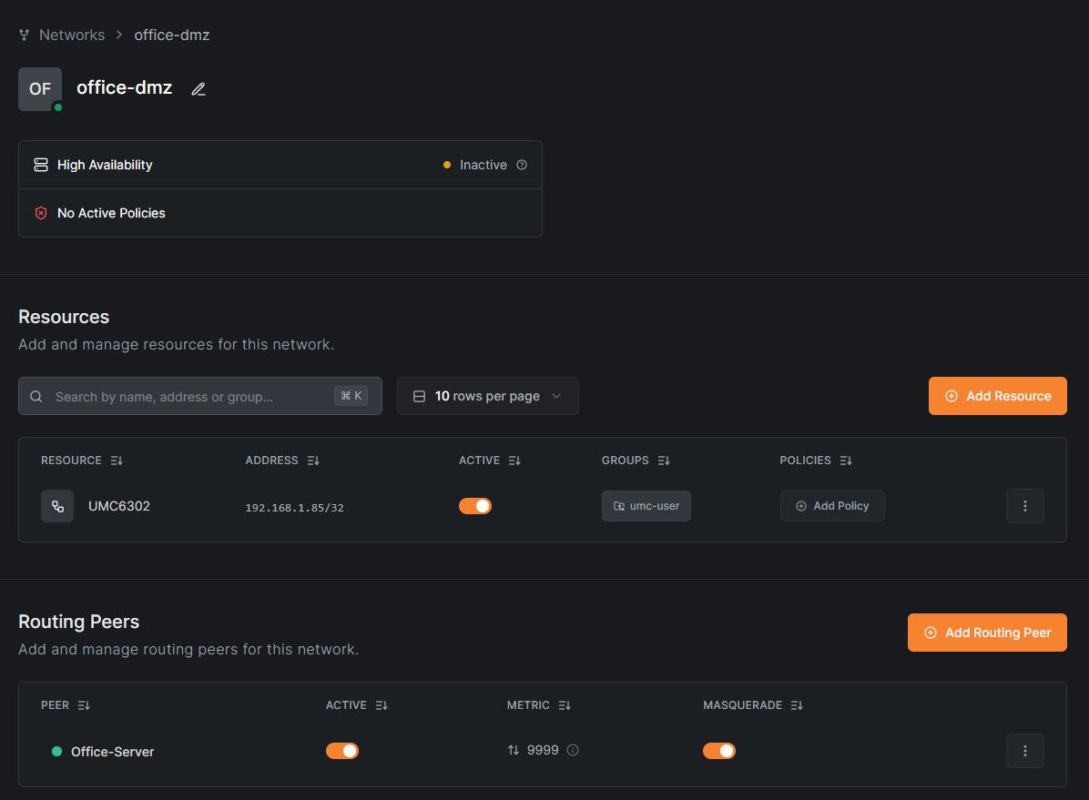

I created this Network:

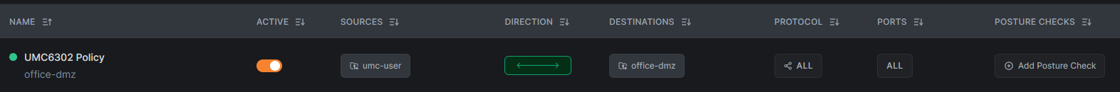

and this Policie:
When I’m in my WiFi, I can use Linphone with the UCM6302 PBX,
but when I’m disconnect the WiFi, I can’t use Linphone any more.
Mobile device is assinged to the umc-user group.
What am I doing wrong?
The policy has to be made to the resource, not the subnet/group i think. Try using the “Add Policy” button within the network. So umc-user → [resource]
