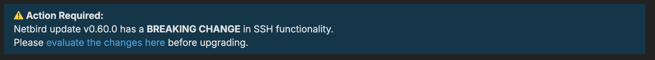

@jfrconley Again, sorry to see you’ve been facing issues, and a description of the specific issues you’re facing would be helpful here. Regarding our messaging for the SSH breaking change - they made were made clear (or so we thought) on Reddit, Slack, GitHub and this forum. On Slack, we made the anouncement 2 weeks prior to the release, and on this forum there’s a banner on every landing page:
Totally willing to admit if our messaging channels/strategy aren’t adequate/suffiecient, though! If you have any ideas on anything more we should be doing in this regard, please share them and I’ll take them to the team for discussion :slight_smile:
