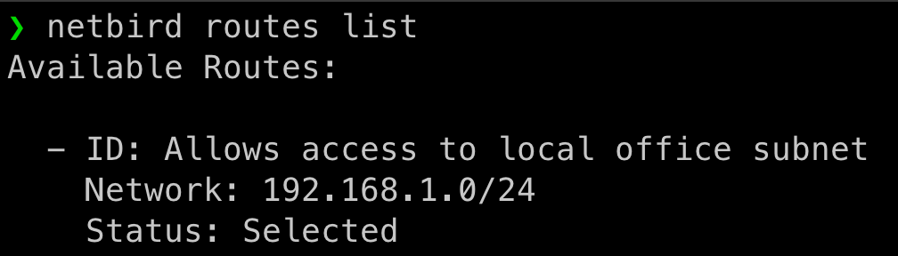

It set up a Network Route Office network access

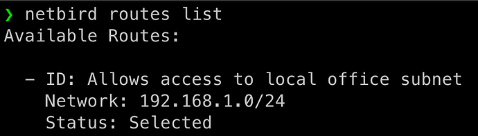

and when the routes are checked it says:
Is this just a wrong shreenshot or do I miss something?
I alway have the Office network access route displayed, in the office and outside the ofice.

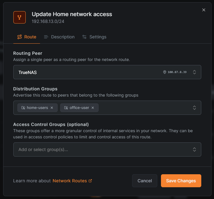

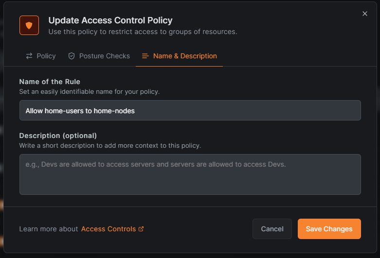

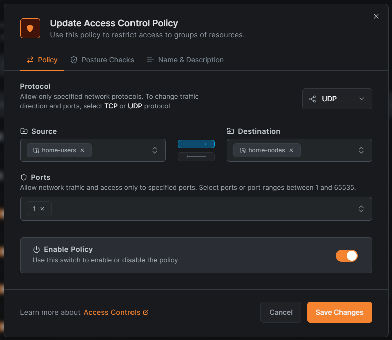

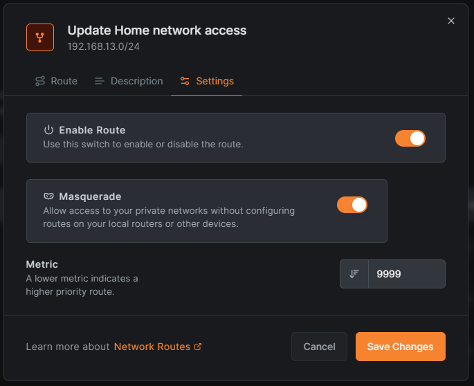

Could you show screenshots or something to show the config used for this setup?

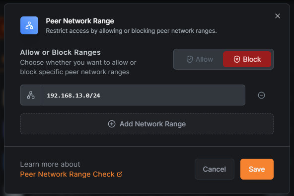

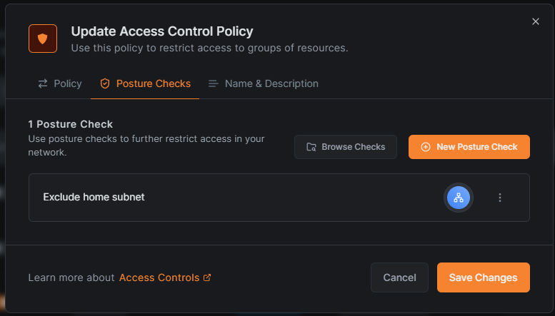

Created a Posture Check
Created a Policy

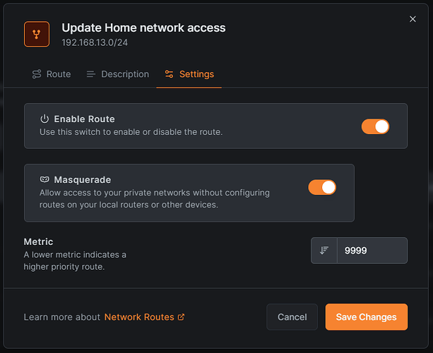

Create a Network Route
Tested Posture Check
Connected to the 192.168.13.0 home-net I get the following routes listed:
In the current version of the posture check it is not dynamic, so when you add the posture check you need to bring down netbird and back up. You should see something in the logs about the ACL being calculated or sent to the peer.
Apart from that it looks right what you did, as long as the subnet on the posture check is the subnet of your home machine
