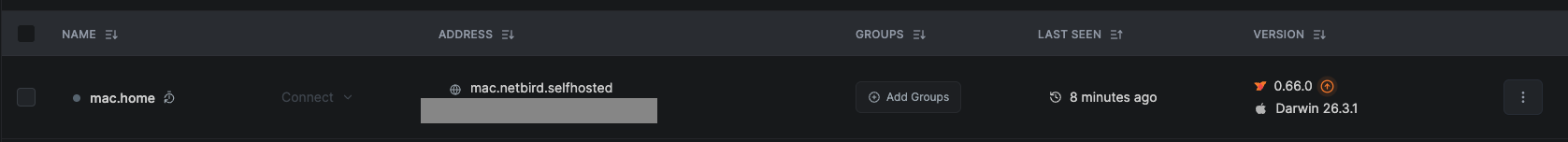

The Peer is registered but is directly disconnected
