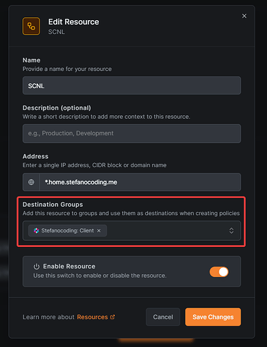

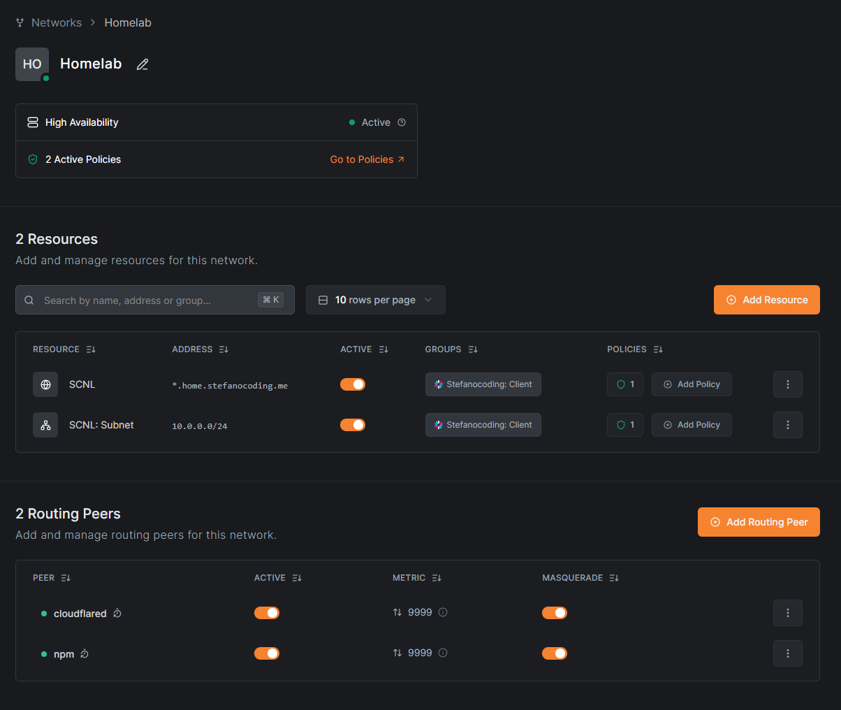

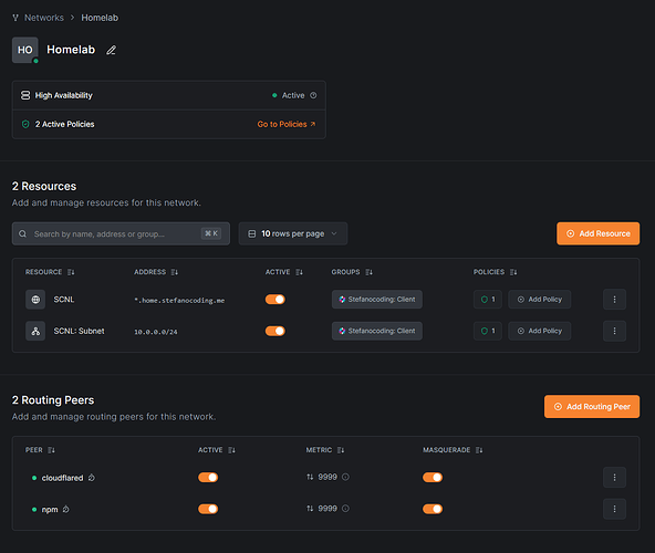

Yes, this is possible in one of 2 ways. If you want the easy way, use a network that has DNS for the services that you want access to. This is what I did in mine:
The simple idea here is that I have the entire subnet availible for anyone who has the “Client” group. And they get assigned the access to it. Then for the Subnet itself, so there are rights to enter into the subnet/network in the first place. I haven’t fully figured out the access policies, so it’s on ALL → ALL at the moment until I find a moment to properly debug it.

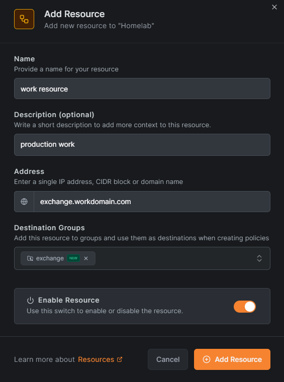

Oh yeah, quite easy. Just define the distribution group
And put that group in the ACL.
Current public network feature, you setup the record like so:
(And probably an ACL with the exchange group)
Then give everyone who needs to access exchange the exchange group. And they can get the domain, assuming there is a custom record, hosts file or similair to reach the machine/application in question. (There needs to be ANY form of reach from one server to the other for that to work, like an open firewall between those servers)

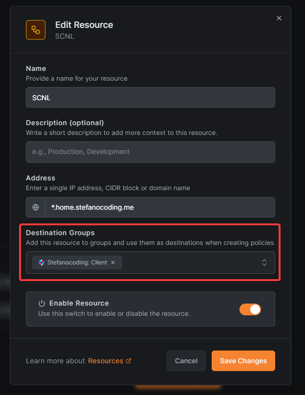

I have tried many things here. Specially with the distribution groups and policies. There is something really strange going on there.

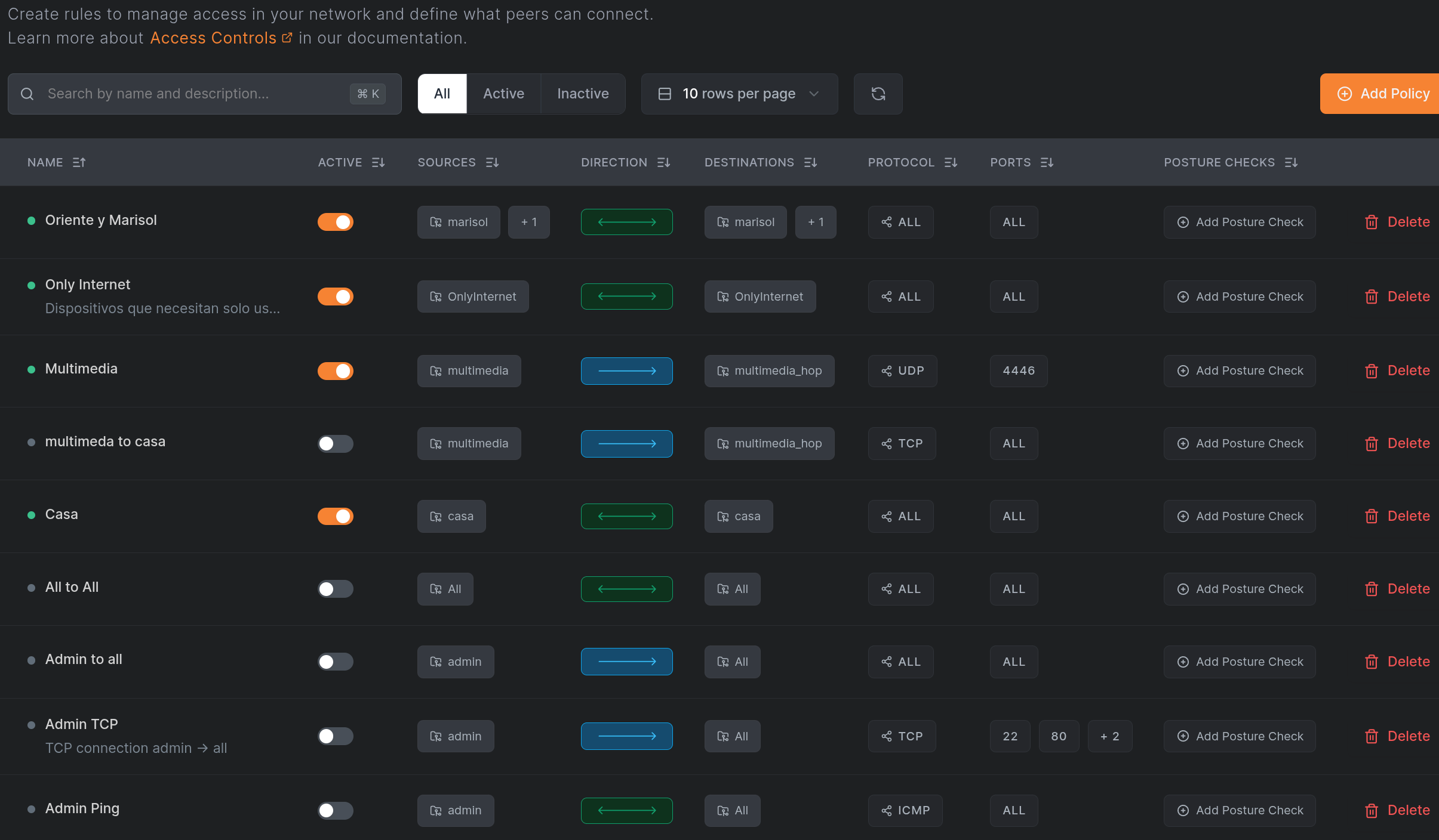

These are the rules. there are many unabled, I am playing with them

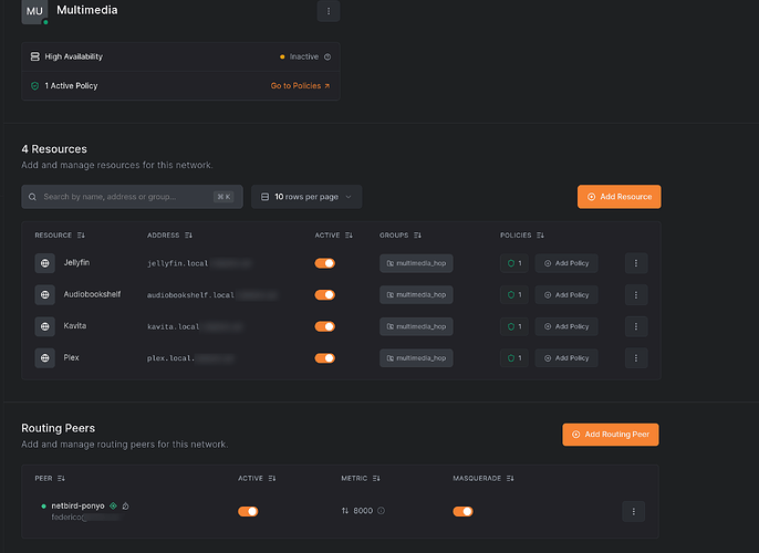

The one that applies here is Multimedia, that has the destination matching the network distribution group. (multimedia_hop)

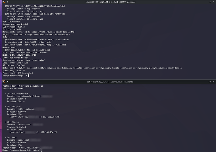

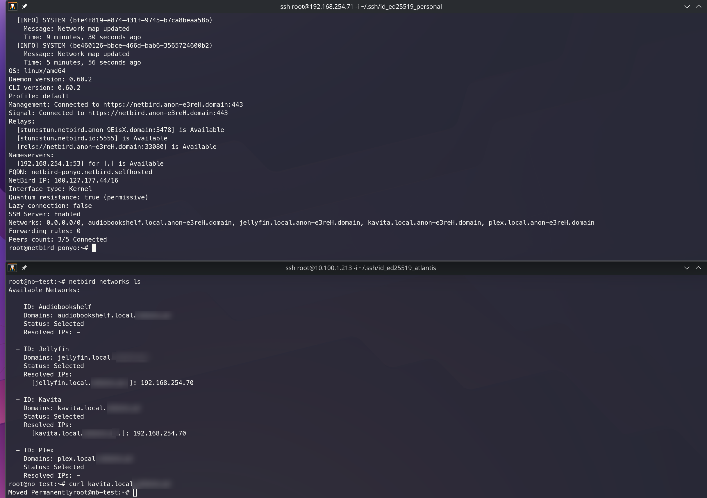

The node above in next picture is just a VM that I use to permanent connect my LAN, that only contains a plain Linux instance running inside my LAN. That peer belongs to group multimedia_hop.
The node bellow is the one with only multimedia group assigned. That’d be just one of these external users I was talking before.
So this is quite working as I want, really, but policies do not make any sense here.
First all, if you add a destination group in network’s resources, you are forced to add a policy with that group as destination, otherwise those entries in the network list command don’t come up. Even if you have an all to all enabled, it requires you to add at least one rule with that.
Secondly, it requires to add such a rule, but it can be ANYTHING. Here is why I said it must be a bug or something. If look in my Multimedia policy, it is UDP port 4446. Can be anything. Tried any stuff in there. The rule is just needed to unlock the network URLs. That is a bug a guess?
Thirdly, my multimedia user is not even in the distribution group. It belong to the multimedia group, but since there is a rule linking both groups it gets the URLs. That is not expected neither.
Then the behaviour is good. My user node only can query for those 4 URLs from the hop node. Any other returns in error. That is good.
And then the hop node acts are router peer. That is good too. As can be seen in the last command a curl to kavita. The message is fine, since it tries to get to port 80 instead 443 that is the one configured. So it reaches the traefik in the server.
