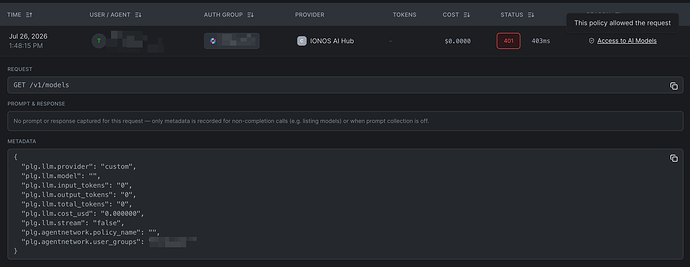

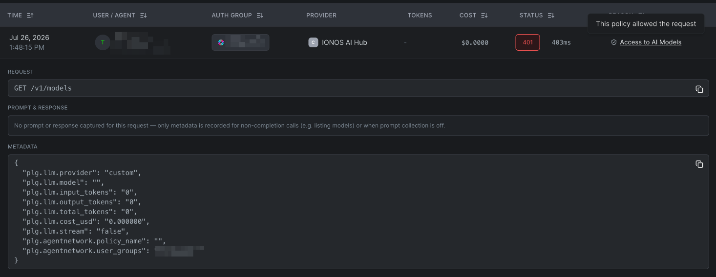

Screenshots
The main question is whether NetBird has a maximum supported API key length for custom AI providers.
The IONOS AI Hub API key is approximately 1,713 characters long. Since direct API calls via curl work with the exact same key and endpoint, the issue appears to be related to how NetBird stores, processes, truncates, masks, or forwards the key.
