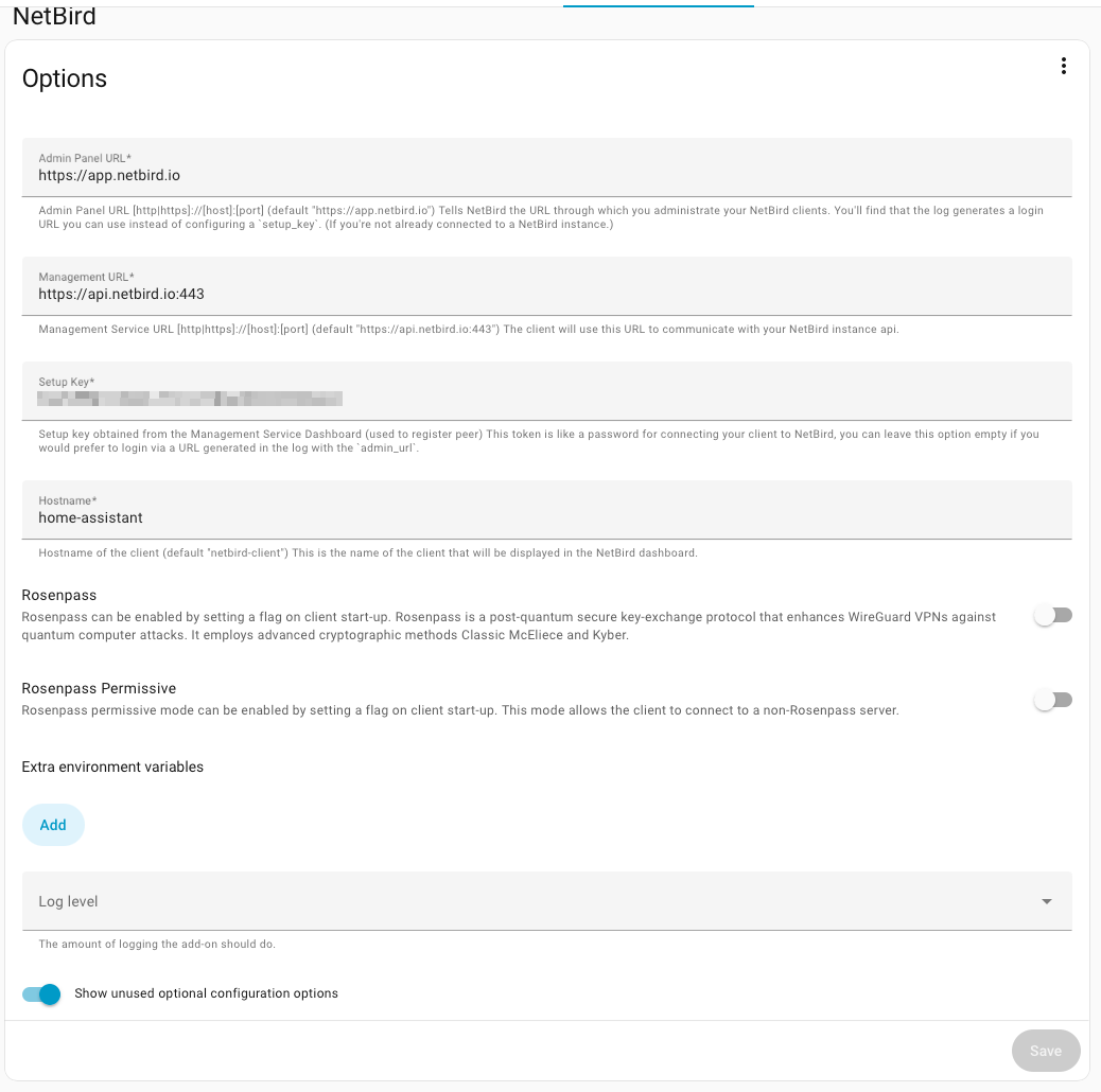

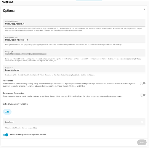

You need to pass a setup key generated in the netbird UI to the homeassistant add-on/app. See the configuration tab in th add-on page.

I set the following options:
  • Admin Panel URL
  • Management URL (same as admin panel URL for me)
  • Setup Key
  • Hostname
Note, that a setup key can only be used once (if not configured otherwise) and is only valid for a certain time. You can see in the dashboard, if the key is still available.
(since the setup key is used I should be able to delete it in the configuration, but I have not tried).
Works for me.

It looks like your management URL is pointed to the wrong location (or you modified the log to hide the details).
As you can see from my setup, my admin-url and management-url are the same except for the port. Also as stated in previous comments, ensure your key is still able to be used by checking your admin page and seeing the key has uses left or create a new key.
