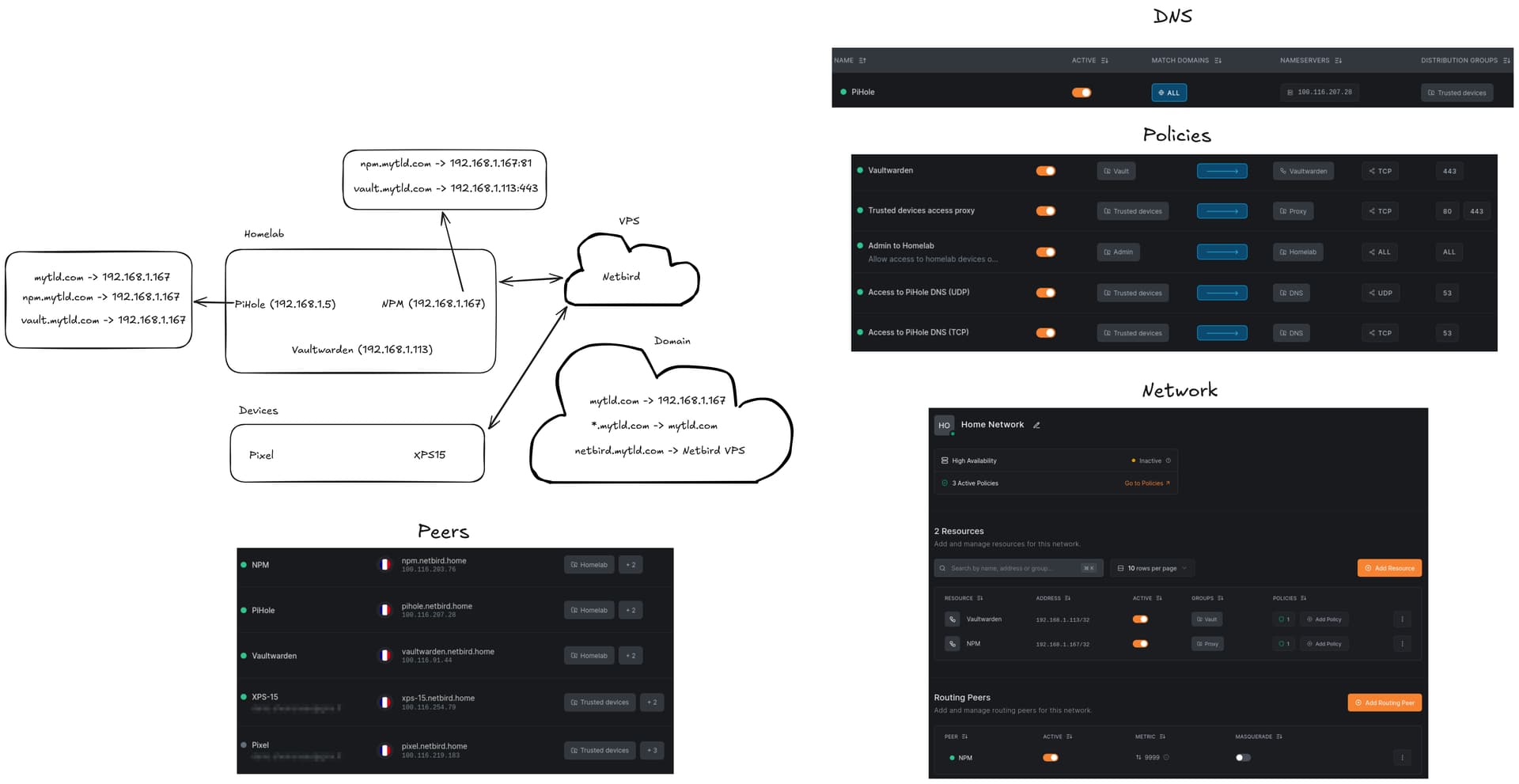

My goal is to use Netbird to allow access to my homelab for friends/relatives and thus to have a granular control on what services they can access. Currently, I’m testing this with three services PiHole, Nginx Proxy Manager and Vaultwarden.
My current setup looks like this:
All of these devices are also peers in Netbird and belong to different groups:
  • Homelab (NPM, PiHole, Vaultwarden): Peers that are in my homelab
  • Vault (Vaultwarden, Pixel): Peers that make use of Vaultwarden
  • Trusted devices (XPS-15, Pixel): Peers that I trust to have access to services on my homelab, in particular those use Pihole as their DNS
  • Admin (XPS-15): Peers that have full access to the homelab
  • Proxy (NPM): Proxy peer
  • DNS (PiHole): DNS peer
Now, the problem is that if Pixel is only in group Trusted devices, it still manages to access both Vaultwarden and NPM, via vault.mytld.com and npm.mytld.com, while being outside the local network (cellular data).
What I would expect, is that PiHole would resolve vault.mytld.com to mytld.com to 192.168.1.167 and then NPM would try to redirect to 192.168.1.113 but should fail since that resource is only for peers in group Vault.

I think this sounds overly complicated. I’ll try to explain my need in more details.
Let’s forget about the schematic I added.
Netbird is running on a VPS.
At home, I have a homelab with the following services:
  • NPM: Reverse proxy and handles HTTPS.
  • PiHole: Used as a DNS, forwards every *.domain.com to domain.com and domain.com to NPM’s IP.
  • Vaultwarden: A service accessible in my local network with vault.domain.com
I have a Pixel phone. I want this phone to access my homelab network entirely and use PiHole, so for instance access vault.domain.com when I’m on the go.
I have a family member who also needs to access Vaultwarden with vault.domain.com, but I don’t want him to access anything else on my home network.
How to make this work?
