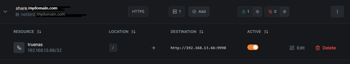

It looks like this:
but I can’t access it on share.mydomain.com
On the local IP with Port I can access erugo
Okay, now I replaced the Resource (Shouldn’t it be named Target?)
from the Resource truenas with the net-IP to the Peer truenas with the Netbird-IP
Now I can access erugo on that URL, but the Authentification is not working.
I tried to set a password and a pin, but the side comes up without asking for the pin or for the password.
Now, I tried the URL from a device, that is not connected to my BirdNet. There I get the Authentificationpage. Is it right, that you don’t get the authentification, when you are conneced to the BirdNet?
