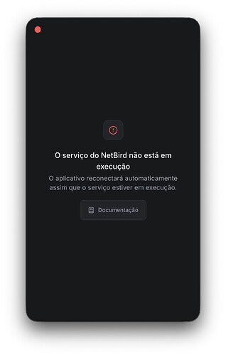

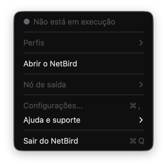

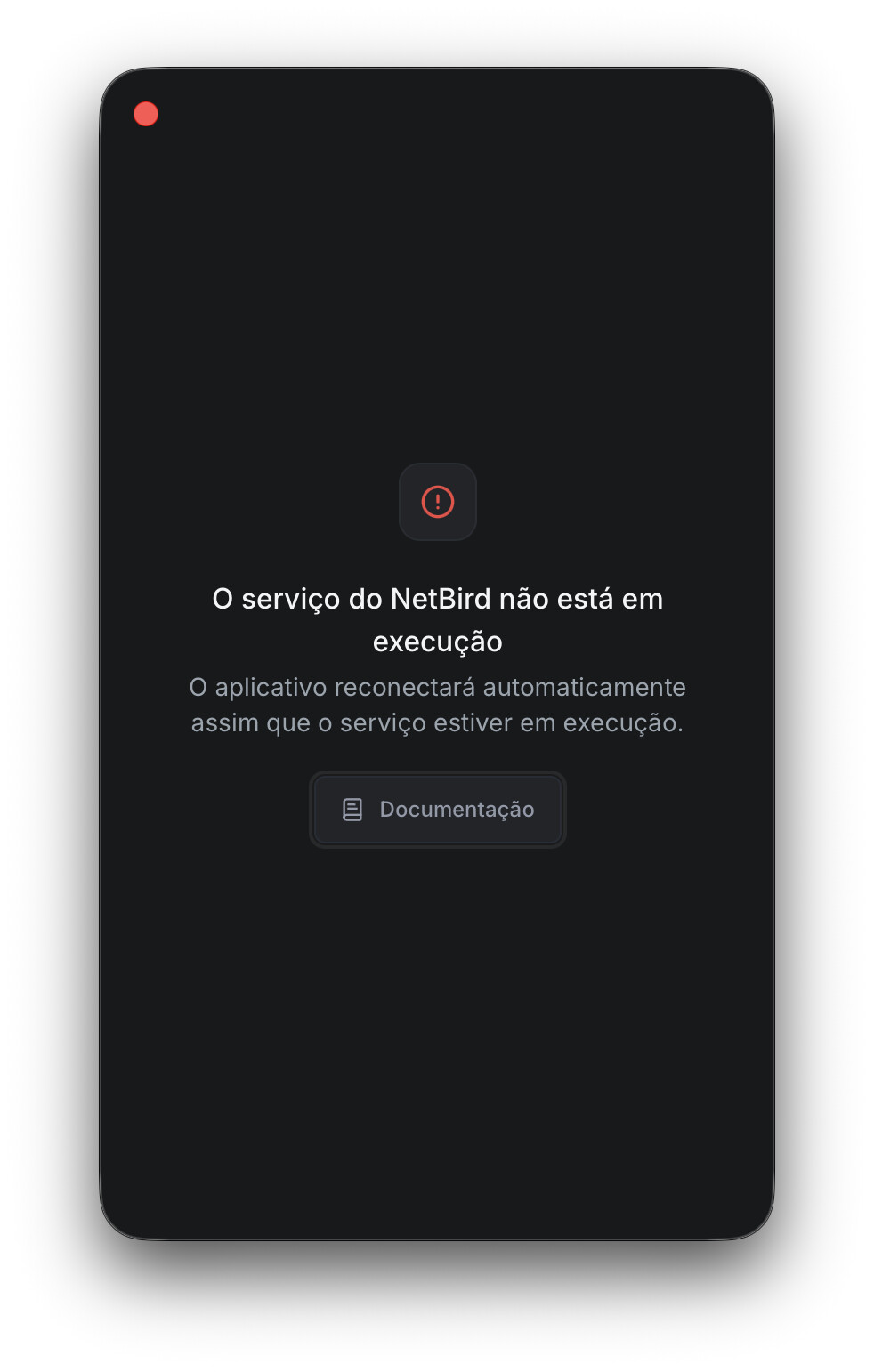

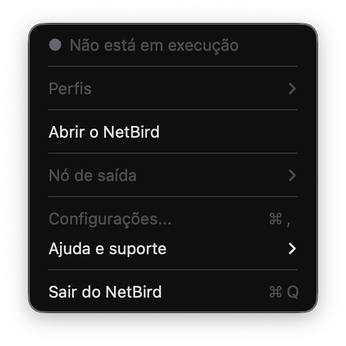

Screenshots
My NetBird is in Brazilian Portuguese.
Print 1 - Main Window
Print 2 - App in Menu Bar
